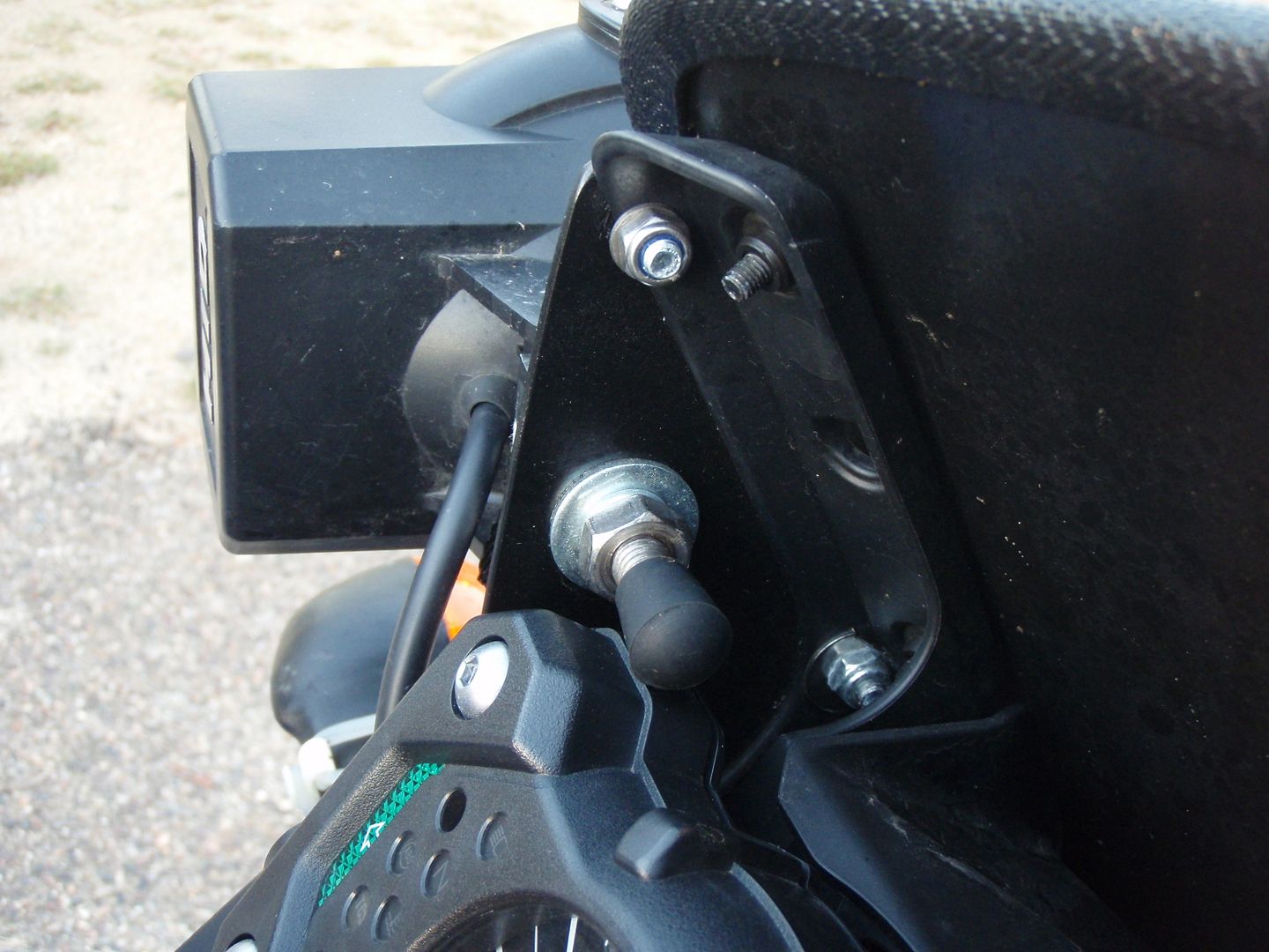

I don't use a normal windscreen, but how I've mounted my driving lights may work for your "birdpin". (I'm guessing that a birdpin is a crossbar. If it is not a crossbar then ignore everything in my post).
I cut some aluminium triangles out of 3mm plate, painted them black and fitted them into the angle formed by the windscreen stays. Although I have mounting bolts for driving lights passing through these triangles, you can see that I could just have easily inserted a long bolt/tube to form a crossbar from one triangle to the other positioned just above the cluster:
Each one of these triangles has supported a big light for over 100,000km.

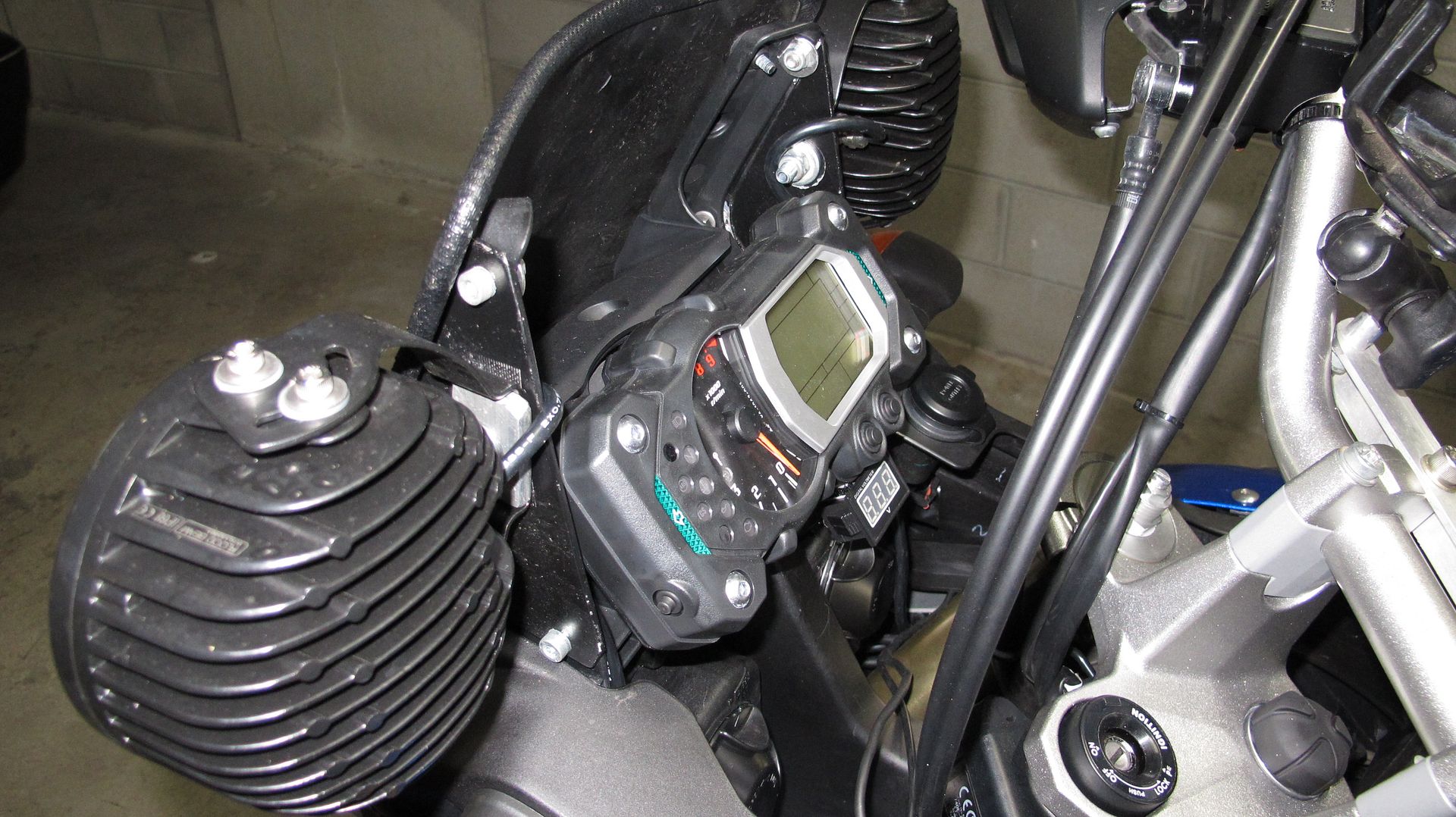

Although instead of a "birdpin" I use a RAM mount attached directly to my aluminium checkerplate 'screen, this is how my satnav looks tucked above the cluster:
