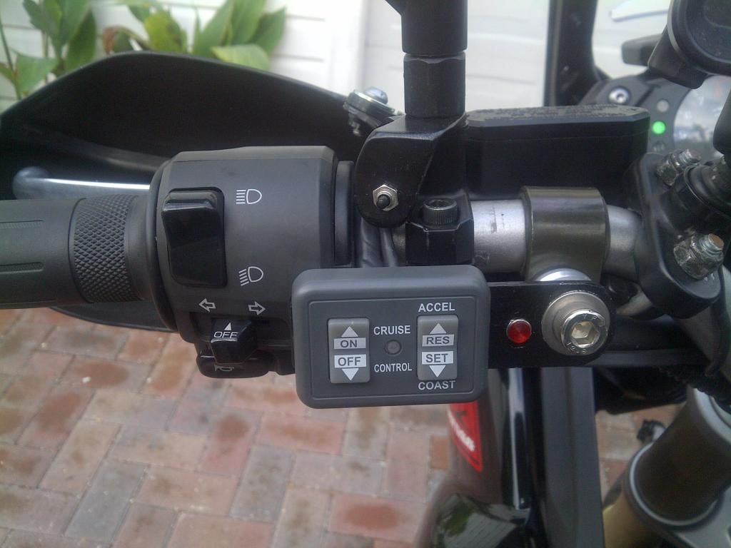

Just did this mod. Outstanding! Great job by Tiger One! ::012::
This is my favorite kind of mod. Easy (with these instructions) , cheap, and a huge improvement! ;D
I did make a few changes. (I always seem to have to change everything  ;))  I already had a cruse control panel mounted on the left and don't have much more room l and I also I really only need the right display button. I rarely change the  trip/odometer display but often scroll through the right button display.  So I just did a single miniature push button switch from Radio Shack. I water proofed it as best I could using heat shrink around the back of the switch to seal it and dialectic grease to seal up the front.  I made a simple mounting bracket from some aluminum angle, and painted it black. total cost is about $4. :)
Here is a picture of the button. (Small button above the CC panel)
I don't know why photobucket keeps rotating this picture! ::010::
I really like being able to scroll through the display with out having to let go of the handlebar.
I don't know why Yamaha didn't do this form the get go.  :question: but at lease it is an easy fix and you can put the switch(s) exactly where you want them.
John  ::001::
